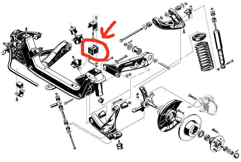

toj28 Posted August 6, 2013 Posted August 6, 2013 http://i876.photobucket.com/albums/ab321/69tussy/0810c4c2-a4d7-443d-979e-4e01f43892f2_zps5f13cea0.jpg?t=1375827332 hi looking for some more help im looking to replace this bush can anyone help on where to buy them thanks Quote
spiney_norman Posted August 6, 2013 Posted August 6, 2013 Never seen a new one for sale! Are yours dead or are you just looking to replace them with new ones for the sake of it? Second hand might be your only option unless they're available in Germany or something. Quote
611 Posted August 6, 2013 Posted August 6, 2013 Same here not seen new ones even on german ebay, i might have some used ones in my box of bits! dont know if opel GT source in the US do anything? Andy Quote
toj28 Posted August 6, 2013 Author Posted August 6, 2013 (edited) I have a bit off movment on the drivers side and looks like the wheel is cambered in slightly if I cant get them ill see about getting a set made possibly from a block off alloy or polly if at all possible Edited August 6, 2013 by toj28 Quote
spiney_norman Posted August 6, 2013 Posted August 6, 2013 That won't affect camber at all, I'd be looking at upper wishbone bushes or the ball joint. 1 Quote
toj28 Posted August 7, 2013 Author Posted August 7, 2013 That won't affect camber at all, I'd be looking at upper wishbone bushes or the ball joint.thanks rob I have removed the complete front end and starting to strip it down Quote
lamchop77 Posted August 7, 2013 Posted August 7, 2013 Best stuff to get them made from is nylon 66, it's a bearing material. Rally lads used to get bushes for leaf springs made up out of it. Hth Chris 1 Quote
toj28 Posted August 8, 2013 Author Posted August 8, 2013 well ive found the problem I think the bolt that's called the bolt from hell lol is bent think its had a dunt at some point this will explain why passenger side is all been replaced drivers never done and to top it off trying to remove the bolt it snapped tried it on a press we about 6 ton no joy so now to try the bottles we some heat Quote
