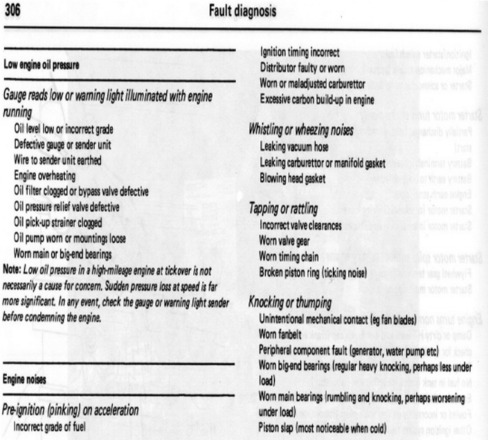

Have you checked compression ratio? Info below taken from Haynes Manual
Edited by robah
Info not dispalying correctly?
