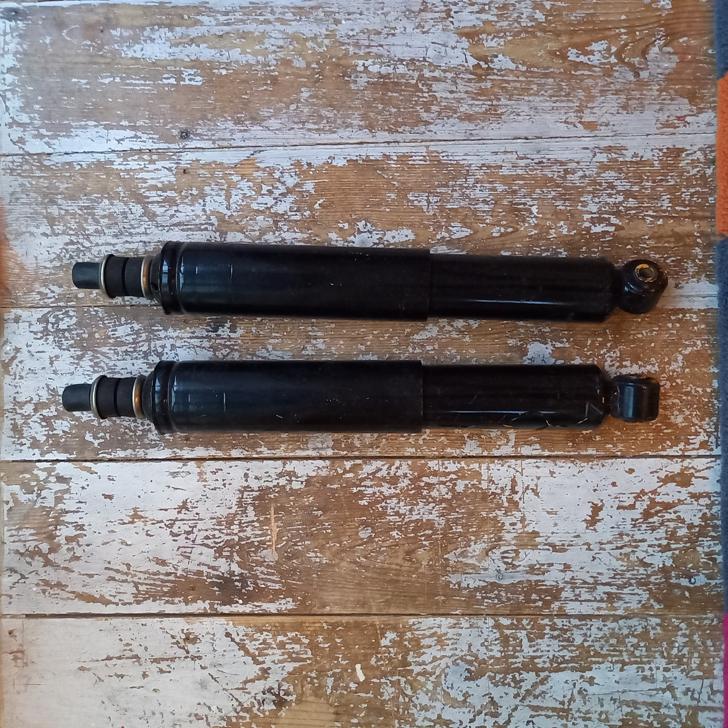

611 Posted May 5 Share Posted May 5 1 hour ago, Raza said: thanks, is this red are the same hight like original? I need higher about 3-4cm because my Manta looks like a speedboat from the side. Have you checked the old ones? as the rubber ones usually degrade and the sprint goes through the rubber. these are the same height but dont compress. I suppose you could get two sets and chop the lip off of one and add two to each side. Have you had the shocks and springs off to see what its all like under there? They might have added lower springs or shorted shocks, do you know what the shocks are? are they the right ones? I have the set of Koni adjustables from mine that worked fine but i just replaced them when i did the new springs and top hats. They are sat in a box in the loft, if you want them, you can have them if you cover the postage to you? This is how mine sits with length uprated springs, poly top hats and standard height Koni adjustables. Quote Link to comment Share on other sites More sharing options...

611 Posted May 5 Share Posted May 5 51 minutes ago, Raza said: I didn't remove the shock absorbers and springs, but everything looks original like 99% of the car. I was thinking of buying lowered KAW springs maybe to straighten the car and make it look lower, better. You have adjustable Koni shocs ? I think I just need springs or caps , I will see little closer. Maybe I will take kaw but dont know what size is better 60/50 or 80/70 Yep, Koni shocks. They are only adjustable in ride, not for height. I used standard speings (but uprated) on the back and then had a set made for the front as that sat too high. https://www.koni.com/en-US/News-Events/News-Releases/Reactivated-application-for-Opel-Manta-A-and-Kadet/ Worth taking one side off and having a look to see what you have as you might find they are not the right ones and then if you got a set that were lowered you could end up with the same problem. The A series usually seems to sit ok on the back and too high on the front. I have never looked at KAW to see what setup the have. Might be worth looking to see if there is any info on any of the German website to see what a standard height spring for the A series is? Andy Quote Link to comment Share on other sites More sharing options...
Raza Posted May 8 Author Share Posted May 8 I didn't see a picture of your manta before, now it has appeared. Tastefully arranged, top! I took off the rear wheel and looked, the springs are black with a small yellow mark, the rubber parts looks good. I will have to remove the entire rear axle to put new higher rubber hats and maybe springs because this tool I have for compresing springs cannot do it. The front and rear part is quite soft when I press with my hand .Maybe your Koni would really help with the new higher rubber hats. Would you really send me your Koni to me? Quote Link to comment Share on other sites More sharing options...
611 Posted May 8 Share Posted May 8 Thanks, it took a while to get to this condition 🙂 Sometimes you can get away with jacking the car up under the spring cup to compress them and then use some strong rope to tie around the coils then take the panhard bar off and lower the axel and pull the springs out. If they need quite a bit of compressing to get them out then i expect they are standard height ones as usually lowered ones are much shorter and stiffer and come out easier. If you take the diff right out make sure you drain the oil as if you disconnect the prop shaft you will lose the oil out of there when you drop the diff. The shocks are just sat in the loft getting in the way and i would probably never get around to selling them so if they are of use to you and it helps you out you can have them. I would need to check the cost of delivery to you. Are you in Croatia? Here is a pic of them. You can see the yellow paint on the on the mounting point which Koni only used on adjustable ones. You would need to check what they are set to as on the new ones i have them on the softest setting which is still quite hard 🙂 Andy 2 Quote Link to comment Share on other sites More sharing options...

Raza Posted May 10 Author Share Posted May 10 I had a B GTE. 20 years later I wanted it again but I found an A model at old grandmother :)) It's really special to drive gte with a light rear end with 100+ horse power seats at floor level. It had momo rims and a momo steering wheel, it's hard for me to talk about it. If you know someone, he would sell it with, not a lot of rust. ...back to reality, I will try to remove the springs in another way, so I will know more. Yes, I am in Croatia, where do you live Andy, no problem for transportation costs, it's a Koni. Can send you the address in a private message. Ivan Quote Link to comment Share on other sites More sharing options...
