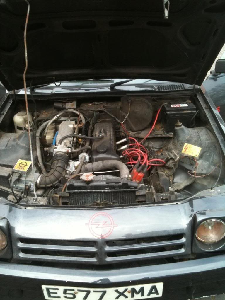

Mototechnics Posted March 22, 2011 Author Share Posted March 22, 2011 Car in now in Norfolk (Pics to follow). Initial inspection reveals rust, rust and more rust but not as bad as first thought. Found a 4 inch deep puddle in the spare wheel well. Looks like a repair weld took away the drain hole - I'm sure there was a drain hole in my last three Mantas (but the last one left home in 1991 so the memory may be wrong). Bailed out now and drying nicely. Starts and runs nicely and drives OK but it 'aint a V8. Anyone looking for a runing Manta 2.0ltr engine and gearbox you know where I am Now on the case of a Rover 3500SDI engne and 5 speed manual gearbox which is only a few miles from me. Playing telephone tennis with the guy at the moment (he phones me, I'm out-I phone him, he's out. you know how it goes) Funny how all of a sudden I've got people who I've never met before offering to help me because they used to have one in the eighties(or a Crapi - yes I spelt it right) Paul1393 - Yes will be in touch Quote Link to comment Share on other sites More sharing options...

Mototechnics Posted March 28, 2011 Author Share Posted March 28, 2011 (edited) 28th March 2011 - The before shots This is just what I can see without taking her apart. Who is that handsome devil in the reflection? Passenger door jacking point?? Now there's a suprise, rust around the sunroof Spare wheel well (sorry about the quality) The driver's side main beam light broke like a Christmas Bauble under very slight pressure when I went to take it out!! Laodsa room for a V8 Battery Tray doesn't look as bad as some I've seen on here Genuine mileage honest gov'nor. Could be 108K more like Apparently these seats also come in grey!!! Edited March 28, 2011 by Mototechnics Quote Link to comment Share on other sites More sharing options...
paulmanta Posted March 28, 2011 Share Posted March 28, 2011 So All the usual places Mantas go bad then, Strip it down to a bare shell and poke the hell out of it, the thick underseal/sheet sound deadening int he foot wells and boot is great at hiding water and rust. Quote Link to comment Share on other sites More sharing options...
Devil Fish Posted March 29, 2011 Share Posted March 29, 2011 28th March 2011 - The before shots Passenger door jacking point?? damn rustmice! Quote Link to comment Share on other sites More sharing options...
